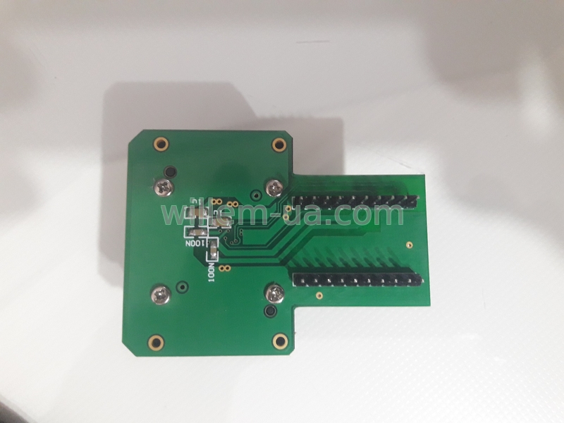

4- I included a video on RT809H EMMC adaptor on TNM.
And also a picture of original TNM adaptor which has many capacitors near the chip which
Avoid errors during programming so we recommend original adaptor Also JRS socket on
RT809H can dismantled by 4 screws and directly installed on TNM pcb.

вот фотка низа адаптера, о котором выше речь.
Прикрепления: 9923572.jpg (212.2 Kb)
