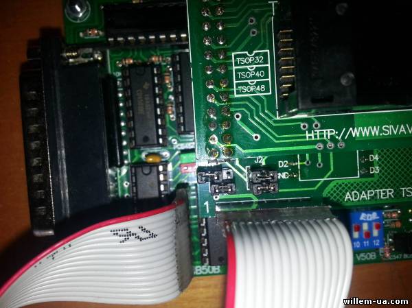

phantomДата: Понедельник, 2013-09-30, 16:19 | Сообщение # 5
Сообщений: 17
here's my willem
with the eeprom m29w800ab, when i click erase, at 17% it says erase complete, but when than i try to write it says after some minutes this error

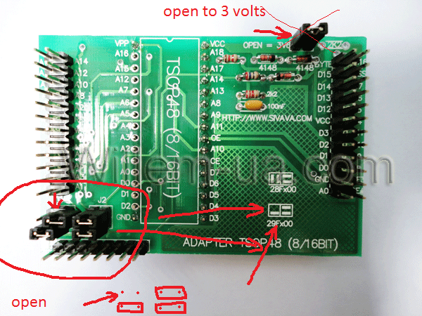

AdminДата: Среда, 2013-10-02, 10:22 | Сообщение # 10
Цитата (Admin)
jumper on the adapter voltage selection should stand 3v
Цитата (Admin)
jumper, a group on the adapter, stand in position 29? as pictured on the adapter?
not that no other you did not!
Why is the jumper to 3 volts??
The adapter is written, open to 3 volts
You put a jumper there?? What for? The first mistake!
Second, as you are jumpers for 29 chips??
Wrong!
Posmotirte as pictured on the adapter, and how you have set?
Wrong!
Take a picture of the adapter, I'll show you how to put the jumper!
I told you about it, wrote a few days ago.
You ignore what I write.
Прикрепления: 8882887.png (389.7 Kb) · 0258615.jpg (47.3 Kb)

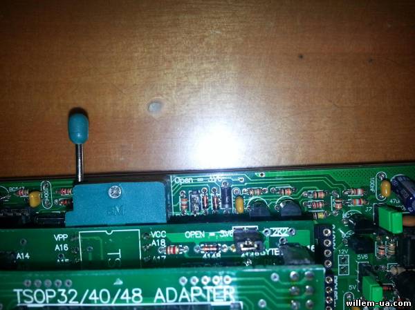

phantomДата: Среда, 2013-10-02, 10:59 | Сообщение # 11
Сообщений: 17
like you see in the picture, programma should be right
i left the 3,6jumper on the adatper because there isn't the 3,6v jumper on the programmator
the second jumper on the left angle isnt' connected...so i think the problem should be another
Прикрепления: 2274560.jpg (43.2 Kb)

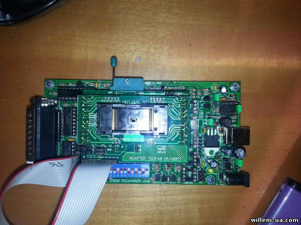

phantomДата: Среда, 2013-10-02, 11:08 | Сообщение # 13
Сообщений: 17
look here maybe you understand better
Добавлено (02.10.2013, 09:08)
ok admin dont' angry with me, i want your help! so to work, there must be the jumper on the programmer and not on the adaptor right?
Прикрепления: 5733106.jpg (42.5 Kb) · 7141212.jpg (42.7 Kb)
AdminДата: Среда, 2013-10-02, 11:12 | Сообщение # 14
above, I gave you a photo, marked in red, as it should be!
Remove the jumper on the adapter, where it is written - is open to 3volta!
Put a group of jumpers as in the picture for the 29 series!
The more I write, not what you will not! Answered!
Do what you write!
Прикрепления: 4286968.png (389.7 Kb)

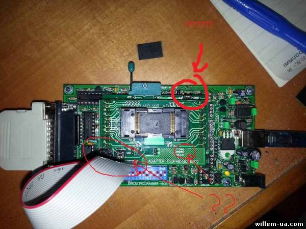

phantomДата: Среда, 2013-10-02, 11:19 | Сообщение # 15
Сообщений: 17
ok done like you said: 3 jumpers on the adapter e no jumper on the 3,3volt adapter
it erase the chip at 17% and then it says "erase complete"
it says that it is bank but as soon as i click write i tell me error at 0x000000 chip= 0xff buffer = 0x21
